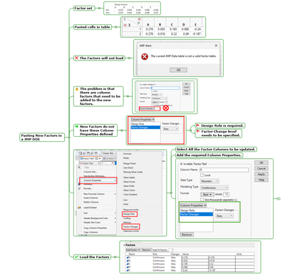

CWBourneJr
Level I
This stream may be out of date by now, solved, or moved to another conversation.
In case it is still an active issue, here is an easy solution to consider.
I found that the reason why imported factor tables do not load is because necessary Column  Properties are missing from the factor columns. These can be easily added by selecting all the new factor columns and adding them with the Column Properties feature
[Design Role and Factor Change level]  Please see the overview below if you are interested.
