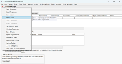

Have your tried using a "Factors table" (and "Responses table") if you need to try and compare several designs based on the same factors/responses levels ?
When your first create a design by specifying each factor, go in the red triangle next to "Custom Design" and click on "Save Factors" : It will create a JMP Datatable that you can keep open or save somewhere.
If/when you want to create other designs based on the same factors and levels, you can (in the same red triangle menu during custom design creation) click on "Load Factors", specify the Factors datatable you have created earlier (or saved in a folder), and JMP will automatically load the factors, rangle/levels and type into the Custom Design platform :

Hi @JMPinthePool, if your factors and factor settings are stored in a data table, you can use Load Factors from the red triangle to populate the factor list. Does this address your request?

For example, in the DoE design window, which you show a screen shot of, currently there are no options here to re-order the factors, no options to insert a new one part way through the list (they always go the end/bottom), no option to load in a 'simple' list of factors and min/max values (eg, copy and paste from somewhere else).
