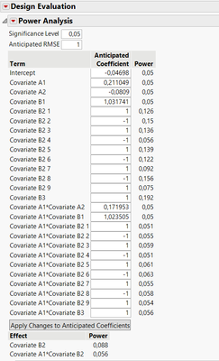

  • When doing the design, due to the joining done on the two tables, not all combinations are explored (covariates from A don't meet all conditions with covariates from B), and I have a poorly efficient design :
Script of the design:

Power analysis :

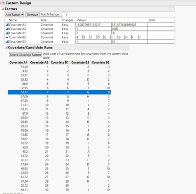

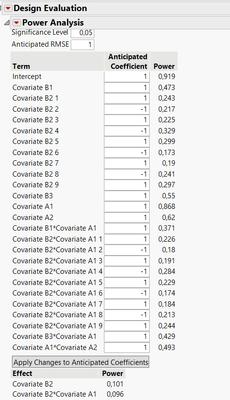

 Since then, I have found an "external" solution by creating a new table with all covariates from the two tables, and so create all possible combinations A/B of the 2 factors from table A with 3 factors from table B thanks to a low-code tool and some looping. When creating the custom design on this table, I find a more satisfactory design :
I joined the different tables  for testing (not the same as for my topic for confidentiality reason, but tried my best to have a mock-up for illustrating the situation).
