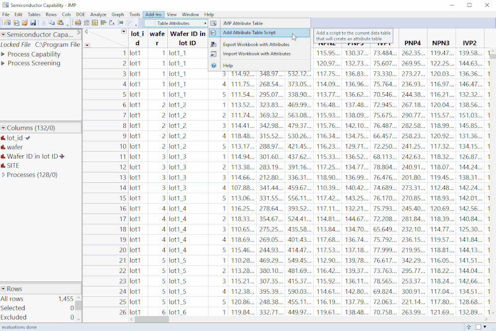

Menu Items

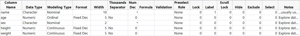

JMP Attribute Table
Create an attribute table for the current data table.
JMP Attribute TableJMP Attribute Table
Add Attribute Table Script
Add a script to the current data table that will create an attribute table.
 "Create Attribute Table" Table Script"Create Attribute Table" Table Script

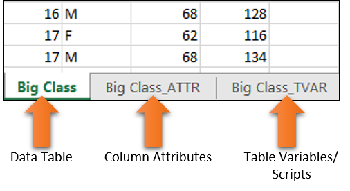

Export Workbook with Attributes
Export table(s) to an Excel workbook with sheets for column and table attributes.
 Export Workbook DialogExport Workbook Dialog
Exported Excel WorkbookExported Excel Workbook

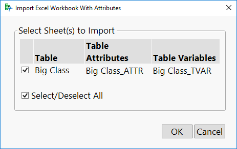

Import Workbook with Attributes
Import table(s) from an Excel workbook with all column properties and table variables/scripts.
 Import Workbook DialogImport Workbook Dialog
