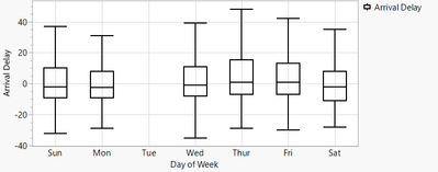

Motivation via date:
at first glance, nobody will notice that the data for Tuesday is missing - there is not even a label on the axis.
To make the missing day appear, one can add a dummy row, Day of Week = Tue, all other entries of the row: missing.

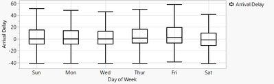

... till somebody uses a data filter - then Tue is gone:
The only way to make it work: a dummy row for EVERY (!!!) item in the data filter.
And if the user has a chance to change the column for the data filter: for EVERY item in ANY column the user may pick.
Ouch !!!

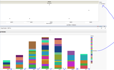

Here is an example from my data where when filtering a defect type, parts with no defects disappear:
Thus I have to add in a dummy row or split the data by defect type, make missing values of the defect type columns become zeros, then restack the data.  This in turn makes my file have 10-30X more rows.  If I had the option to turn on a column option that forces the levels of the column to always appear with no data showing as zero that would be a big help!
