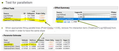

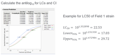

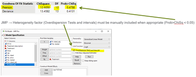

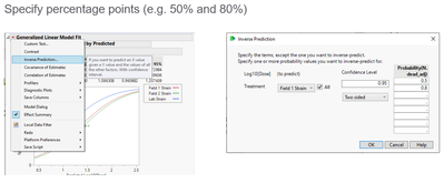

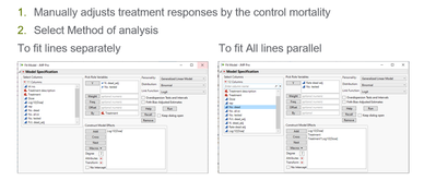

Below, you will find the detailed manual steps required in Fit Model platform to analyse the results of an experiment involving three strains of insects (i.e., lab, field 1, and field 2), each subjected to five doses of an insecticide across three replicates with 20 insects per replicate.
