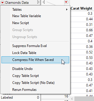

Compressing a large data table reduces the size of the stored file. To compress a large data table:
  1. Click the red triangle next to the data table name in the table panel and select Compress file when saved.
  2. Save the data table.
Compress File When Saved OptionCompress File When Saved Option
Note: The Compress file when saved option decreases the file size. It does not impact the memory that is required to analyze the data. To reduce the file size and memory required for analyzing, use the Compress Selected Columns option.
