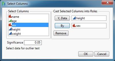

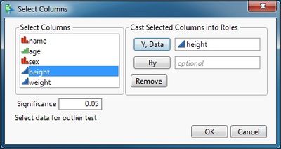

Simply open the data table with the numeric variable to be evaluated, then open and run the script. Select the data column and click Y, Data. Specify the desired level of significance (alpha is 0.05 by default). This example is based on the variable height in the Big Class data table in the Sample Data folder.

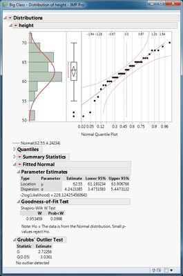

Click OK.
The pattern of the markers in the normal quantile plot appears to be linear and none of the markers is outside of the region designated by the dotted read curves. The sample and, therefore, the population are judged to be normal in this case. The test at the bottom of the platform is not significant at the specified level.
Now the same analysis is performed using a By variable. This example uses sex as the grouping variable.

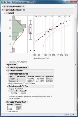

Click OK.
