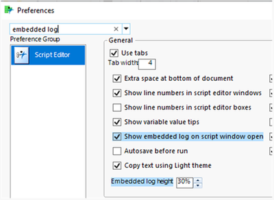

Tip1 Enable JMP Script Editor's Embedded Log
Enabling embedded log allows you to quickly and easily see JMP Log directly in JMP's Script Editor. You can enable Embedded Log from JMP Preferences under Script Editor. JMP16 also allows you to change the height of Embedded log (I personally use values between 25%-30%).

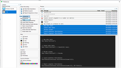

Tip2 For JMP16+ enable Enhanced Log
With JMP16 new feature was released called Enhanced Log. This keeps track what you have done interactively in JMP and provides script to those actions and makes it easier to let JMP write scripts for you.
Enhanced Log can be enabled from JMP's Preferences. You can also make modifications on what is captured and how the Enhanced Log looks.

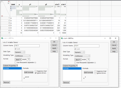

This is fairly common topic in JMP Community: why value from variable isn't getting evaluated into formula for example. This basically means that the values didn't get evaluated "out of" the expressions (variables). Below are for examples to demonstrate the issue and possible solutions (my preferred method is Eval(EvalExpr()) + Expr()).
Example1 Formula
In this example two columns are being created, one without and with Eval(EvalExpr()). The one without is left with the variable name in formula

power = 3;
new_col = dt << New Column("x to " || char(power), Numeric, Continuous, Formula(:x^power));
Show(new_col << Get Formula);
power = 4;
Eval(EvalExpr(new_col = dt << New Column("x to " || char(power), Numeric, Continuous, Formula(:x^Expr(power)))));
Data table and formulas (take note how formulas look like and what has happened to x to 3 values (they are to power 4 now))
If you were to save this data table, reopen it and added new row, you would get following error message, because the data table doesn't know what power's value is.
This is because I'm using Names Default To Here(1); in the example script, but the error is a good thing in this case. If I wasn't using Names Default To Here(1); to start my script (see extra tip), I would add the power variable to global namespace and the data table would still know power value in the same JMP session. Now I might thing that my data table works as it is supposed to and I go sharing the table and who ever I shared it to will be left wondering why it isn't working.
