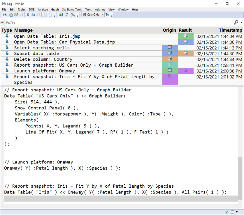

Here’s how it works. Launch JMP and go about your point-and-click business as usual: Import data, clean it up, examine distributions, make graphs, do some analysis. When you’re done, open the Enhanced Log from the View menu. You’ll find a replayable, archivable record of your work. Let’s look at an example:
  • The Enhanced Log window is divided into two panels. The top panel has a list of actions that were performed; the bottom panel contains the corresponding JSL code.
  • Each action captured has information about the origin (usually what data table the action was performed on) and the result. There’s also a timestamp.
  • Different data tables and report windows are color-coded to aid with navigation. Click on one of the color-coded blocks to bring forward the corresponding window.
  • Search for specific steps using the Filter box at the top of the Enhanced Log window.
  • Any superfluous actions can be deleted if desired: Click on the row to select it, then choose “Clear” from the red triangle menu or right-click context menu.
  • Many JMP platforms will generate two recorded actions: one capturing the platform launch dialog choices, and a second snapshot generated automatically when the resulting report is closed. The snapshot helpfully captures any details that were added to the report later from red-triangle options.
  • To save the actions as a JSL script, choose “Save Script > To Script Window” in the red triangle menu.
