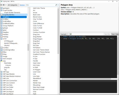

Most of these different graphical objects/functions can be found in the scripting index under category Graphics:
- Graphics Functions (jmp.com)
- And scripting guide Scripting Graphs (jmp.com)

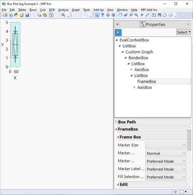

GraphBox will return a reference to DisplayBox[OwnerBox] and FrameBox is somewhere under that
Names Default To Here(1);
New Window("Box Plot Seg Example",   
	g = Graph Box(    
		Frame Size(40, 180),     
		Y Scale(0, 5),     
		Box Plot Seg([1, 2, 3, 4]) 
You can also use Custom Maps to display the real coordinates. All the different methods do have their pros and cons.
