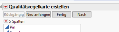

wonderful tips and tricks with XPath:
https://community.jmp.com/t5/Abstracts/I-Can-See-It-How-Do-I-Get-It/ev-p/776041
question: how to make XPath robust so that it works as well with local language settings?
Display Tree Indexing - how does it work?
names default to here(1);
dt=Open("$SAMPLE_DATA/Quality Control/Coating.jmp");
obj=dt<<Control Chart Builder( Variables( Subgroup( :Sample ), Y( :Weight, :Weight 2 ) ), Local data filter );
rpt=obj<<report;
rpt["Control Chart Builder","Weight Limit Summaries"]; // works , even with local language settings - wow!!!
rpt["Qualitätsregelkarte erstellen","Übersicht Grenzen Weight"] // works - but just with German language setting
current report()["Local Data Filter"]; // works, but NOT with local, e.g. German language setting
current report()["Localer DatenFilter"]; // works - but just with German language setting
rpt << xpath("//OutlineBox[text()='Control Chart Builder']"); // works - but just with English language settings
