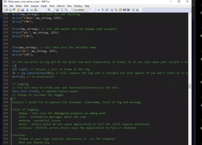

Why does this vedio become blurry when I watch it? How to solve it?
Re: Scripters Club Recording: Building Robust and fail-safe scripts
Hello @lehaofeng mybe the bandwith during the recording changed.
Is there anything you cannot follow?
lehaofeng
Level V
Just like this, sometimes it`s clear,but sometimes it`s blurry.
Ressel
Level VII
Possibly, the issue is on your machine? I couldn't notice blurriness when watching.
