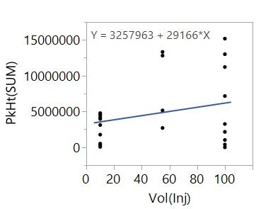

We now want to use this data to build useful models. A straight-line fit is one of the simplest statistical models that we can create. It can also be a very useful model. So let’s start simple by fitting a straight line to PkHt(SUM) versus Vol(Inj):
![1_2 Main effect of Vol(Inj).jpg 1_2 Main effect of Vol(Inj).jpg](https://community.jmp.com/t5/image/serverpage/image-id/10713iC45E1EC6FDB7B831/image-size/large?v=v2&px=999)
We don’t use graph paper, a ruler and our judgment to fit the line, as we did back in my high school physics class. Software like JMP will find the line of best fit using a method call least squares regression. The simple linear regression model that we are given is represented by the equation,
Y = 3257963 + 29166*Vol(Inj).
It has two parts:
- The intercept parameter tells us that we can expect a PkHt(SUM) of 3257963 when the injection volume is 0 microlitres.
- The slope parameter tells us that we can expect PkHt(SUM) to increase by 29166 for every microlitre increase in Vol(Inj).
In DoE, we call this the main effect (ME) or main linear effect (MLE) of Vol(Inj). It is a useful because it enables us to understand the effect of injection volume on the peak heights on our chromatogram, assuming the linear relationship is a good enough model.
It happens that we need only two data points to be able estimate this main effect model: One at the lowest setting of Vol(Inj) and one at the highest setting would suffice. More generally, you need, at a minimum, as many data points as you have parameters in the model. Here, we have a just an intercept and a slope parameter.

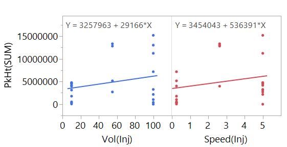

So why do we have all these other data points? With the other data, we can add to our model. We can separately model the main effect of both Vol(Inj) and Speed(Inj), for example.

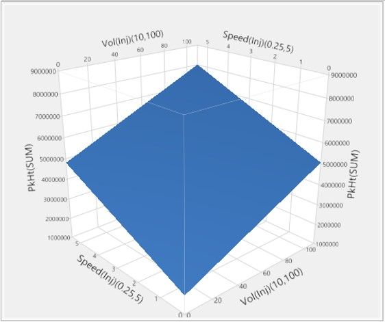

Even better, we can simultaneously fit the main effects of Vol(Inj) and Speed(Inj) in the same model.
![1_4 surface plot ME of Vol(Inj) and Speed(Inj).jpg 1_4 surface plot ME of Vol(Inj) and Speed(Inj).jpg](https://community.jmp.com/t5/image/serverpage/image-id/10715i20FC3975C9DDA847/image-size/large?v=v2&px=999)
Now instead of a line, we are fitting a plane. We can also visualise this model using the Profiler plot that we used in the previous post in this series.

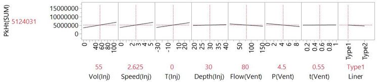

When we fit the effects of two or more factors, we call this multiple linear regression (MLR). We can extend this to our other factors to give us the full main effects model. The Profiler plot is useful here because the equations for MLR models can be quite difficult to interpret [1], and it is a challenge to imagine a plane in eight dimensions!
![1_6 Profiler plot full ME model.jpg 1_6 Profiler plot full ME model.jpg](https://community.jmp.com/t5/image/serverpage/image-id/10718i1BF4AB006B397A21/image-dimensions/746x164?v=v2)
With this model, we have a lot of information about our system that will be useful for finding settings that maximise our signal and our ability to detect impurities at low concentrations.
Going back to question of the number of points we need to fit a line – do we really need 26 data points to fit this model? In fact, an experiment with just nine runs would be enough to build this model because we have one intercept and eight slope parameters to fit. With the additional data from our 26-run experiment, we can build a model to understand more about the process.

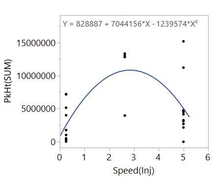

Hopefully, you recall quadratic functions from high school. These functions feature X^2 terms and can describe curvilinear behaviours. Essentially, these models allow the slope effect to change as the factor, X, changes. For example, just looking at PkHt(SUM) versus Speed(Inj):
![1_7 Quad of Speed(Inj).jpg 1_7 Quad of Speed(Inj).jpg](https://community.jmp.com/t5/image/serverpage/image-id/10719i7658831A6B150D0D/image-size/large?v=v2&px=999)
The data tells us that the slope of the relationship between PkHt(SUM) and Speed(Inj) is changing with Speed(Inj) and there is a maximum near the centre of the range. The quadratic model,
Y = intercept + a*X + b*X^2,

This model can describe the curvilinear behaviour and so gives us better information to understand the effect of changing injection speed compared with the simple main effect model. There is a bit more terminology that is useful to know: We say that the main and quadratic are both effects of the factor, and the quadratic is a second-order effect of the factor.

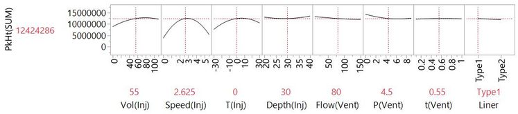

With the data from our 26-run experiment, we can fit a main and quadratic effects model for all continuous factors (with just the main effect of Liner).
![1_8 Profiler plot of full quadratic.jpg 1_8 Profiler plot of full quadratic.jpg](https://community.jmp.com/t5/image/serverpage/image-id/10720iC45E70CC5DE0C7E9/image-dimensions/747x165?v=v2)
We can see that this is telling us some very different things from our main effects models. These are things that we need to know to meet our objective of optimising the LVI set-up.
