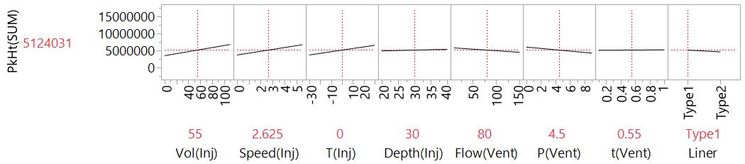

When we fit the effects of two or more factors, we call this multiple linear regression (MLR). We can extend this to our other factors to give us the full main effects model. The Profiler plot is useful here because the equations for MLR models can be quite difficult to interpret [1], and it is a challenge to imagine a plane in eight dimensions!
With this model, we have a lot of information about our system that will be useful for finding settings that maximise our signal and our ability to detect impurities at low concentrations.
Going back to question of the number of points we need to fit a line  do we really need 26 data points to fit this model? In fact, an experiment with just nine runs would be enough to build this model because we have one intercept and eight slope parameters to fit. With the additional data from our 26-run experiment, we can build a model to understand more about the process.

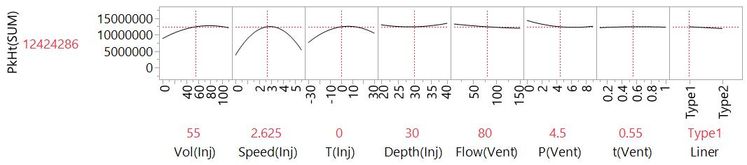

This model can describe the curvilinear behaviour and so gives us better information to understand the effect of changing injection speed compared with the simple main effect model. There is a bit more terminology that is useful to know: We say that the main and quadratic are both effects of the factor, and the quadratic is a second-order effect of the factor.
With the data from our 26-run experiment, we can fit a main and quadratic effects model for all continuous factors (with just the main effect of Liner).
We can see that this is telling us some very different things from our main effects models. These are things that we need to know to meet our objective of optimising the LVI set-up.

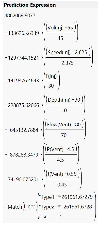

[1] As an example of what a multiple linear regression model looks like in mathematical notation, below is the expression for our full main effects model. This is why we like the Profiler plot!
1_9 Expression of full ME model.jpgDid you miss any posts in this Why DoE series? No worries. Find all of them here.
