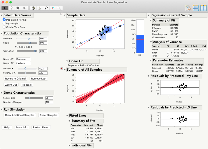

The applet Demonstrate Regression, for example, addresses concepts including “best guess” linear fit vs. least squares fit, residual and sum of squared errors, population characteristics vs. sample statistics, and uncertainty. Data can come from a configurable normal population, can be imported from an open data set or can be self-made by setting all data points manually.
Module “Demonstrate Regression” showing sum of squared errors (SSE) and fits for 100 samplesModule “Demonstrate Regression” showing sum of squared errors (SSE) and fits for 100 samples

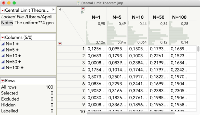

What is it? The calculators are scripted tools for a handy calculation of confidence intervals, sample sizes and p-values for various hypothesis tests. Simulators are JMP data tables with saved formulas, for example, to create data to show the Central Limit Theorem, simulate dice rolls or produce prim numbers.

Simulator Central Limit TheoremSimulator Central Limit Theorem
Where to find? JMP sample data (Help > Sample Data > Calculators; Help > Sample Data > Simulations). All calculator scripts are also available as JSL source files if you want to change them (Help > Sample Data > See an Alphabetical List of all Sample Data Files > Calculators). For simulators, you can open the stored formulas in the Formula Editor by clicking the ‘+’ icons in the Columns panel.
How to use? The calculators are self-explaining and pretty easy to use; just tell your students where they can be found. To create data in a simulation data table, choose Rows > Add Rows… and set the number of rows you want add, based on the formula for each column. Some simulators also have stored scripts, to analyze the new data by running the script (click the green triangle).

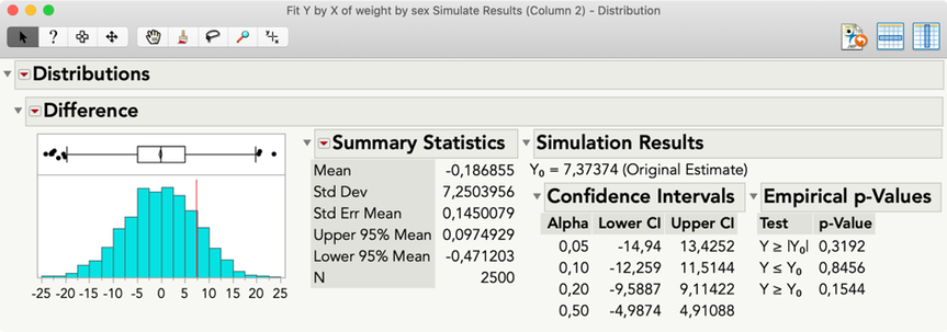

Where to find: In JMP Pro, which comes with every academic site license, Bootstrap and Simulate are just one (hidden) click away. In nearly all JMP reports, students can simply right-click the statistics of interest and select Bootstrap or Simulate.
How to use? Bootstrapping asks for the number of bootstrap samples* and creates a new data table, including the statistics for the original sample (excluded row) and for all bootstrap samples. JMP adds a Distribution script to the new data table that shows the empirical confidence limits at different levels.

Two-sample t-test: Original estimate (red line) of the difference between the means and empirical (simulated) p-values and confidence intervalsTwo-sample t-test: Original estimate (red line) of the difference between the means and empirical (simulated) p-values and confidence intervals
