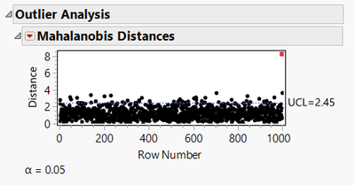

A DM plot for the data set shown in Figure 1 is shown below:
Figure 2:  Mahalanobis Distance plot for 1,000 data points from Figure 1Figure 2:  Mahalanobis Distance plot for 1,000 data points from Figure 1
Figure 2 shows all data points in row order versus DM on the Y axis. The value of DM for each point represents the standardized “distance” of each point from the centroid of all data points. The red data point clearly stands out from the remaining points, so it would warrant further investigation as an outlier.

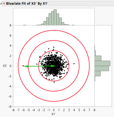

Note the red point of interest in Figure 3. We can easily calculate the mean and standard deviation of the 1,000-point sample in each dimension, and we can calculate the Euclidean distance from the red point to the centroid of the points using the Pythagorean Theorem. For multidimensions:
In fact, we can draw circles centered on the centroid representing equal distances from the centroid, as in Figure 4:
Figure 4: Scatterplot of 1,000 uncorrelated data points, with equidistant circles from centroid overlaidFigure 4: Scatterplot of 1,000 uncorrelated data points, with equidistant circles from centroid overlaid
In Figure 4, the circles represent distances of 1, 2, 3, and 4 units (from smallest to largest) to the centroid of the points. Here it is clear to see that the point in red is the furthest from the centroid of the points. Its distance is represented by “d”.

We can generate the Mahalanobis plot by going to Analysis/Multivariate Methods/Multivariate, selecting the columns, then from the red dropdown select Outlier Analysis/Mahalanobis Distance. For the example data set of Figure 1, this gives:
Figure 7: Mahalanobis distances for 1,000 data point sample (repeat of Figure 2)Figure 7: Mahalanobis distances for 1,000 data point sample (repeat of Figure 2)
Here we see that the data point in Row 1 of the data table has the largest distance (DM), indicating it is the furthest from the centroid of all 10 data points. The blue line represents a 95% upper confidence limit (UCL) on whether we believe the DM is significantly different from zero. The red point is clearly above the UCL, so it warrants further investigation as an outlier.

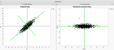

It would be nice if we had a way to rotate the axes in Figure 1 so that they lined up with the data trend, something like this:
Figure 9:  Conceptual rotation of axes for two-dimensional data setFigure 9:  Conceptual rotation of axes for two-dimensional data set
Then we could use the techniques described earlier for standardizing the data to detect outliers.
One way to do this is Principal Component Analysis (PCA). PCA finds the set of orthogonal (mutually perpendicular) axes that best fits the data. You can have as many principal components as you have original dimensions (columns) in your data set. In JMP, PCA can be found in two places: either under Analyze/Multivariate Methods/Principal Components, or under Analyze/Multivariate Methods/Multivariate, and then from the red dropdown next to Multivariate, choose Principal Components/on Correlations. The red dropdown also gives an option to save the principal components back to the data table. Once you have done this, you can use the methods to correct for means and standard deviations outlined above to determine the distance from the centroid.
