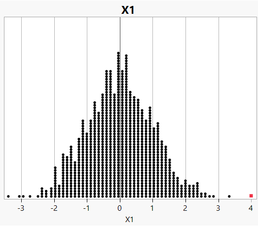

Example 1: One-dimensional data
Figure 1 shows a dot plot of 1,000 samples pulled from a normally distributed population (mean=0, standard deviation=1).
Figure 1: An example with one-dimensional data.Figure 1: An example with one-dimensional data.
The point at X1=4 is highlighted in red. In this case, it is 4 standard deviations from the mean. For a normal distribution (like the one shown above), this is a very unlikely occurrence. In fact, we would expect to draw a “4” from a normally distribution with mean 0 and standard deviation of 1 only 0.01% of the time. This is definitely an unusual observation.

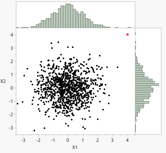

Example 2: Two-dimensional data, independent and normally distributed variables
In the example shown below, we have two input variables: X1 and X2:
Figure 2: A 2D example, with independent and normally distributed variables.Figure 2: A 2D example, with independent and normally distributed variables.
In Figure 2, we have two normally distributed and independent variables, X1 and X2. The histograms next to each can be used to surmise normality. Note the point marked in red at (4,4). Again, we have an outlier that is visually obvious, since it is located far away from the means of either X1 or X2.

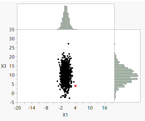

Example 3: Two-dimensional data, normal and independent variables, different means and standard deviations
Let’s go a little further with the two-variable example. This time, we have different means and standard deviations.
Figure 3: A 2D example, with different means and standard deviations.Figure 3: A 2D example, with different means and standard deviations.
The point at approximately (1,27) might be considered an outlier. It is inside the X1 distribution, but clearly outside the X3 distribution.
But what about the red point at (4,5)? Is it an outlier? Our eyes tell us that it might be, but how can we tell? How do we assess it algorithmically? (For the answer to this, you'll have to wait for subsequent blog posts!)

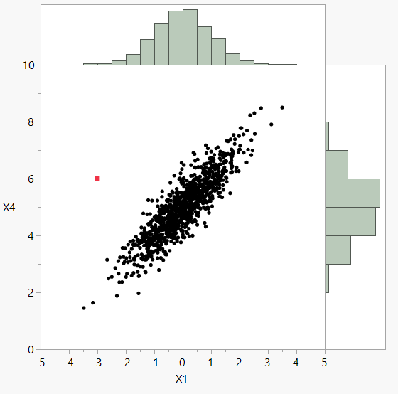

Example 4: Two-dimensional data with correlation between the variables
Below is yet another two-dimensional example, this time with correlation between the two variables:
Figure 4: A 2D example, with correlation between the two variables.Figure 4: A 2D example, with correlation between the two variables.
Visually, the red point at (-3,6) in Figure 4 is quite obvious to the eye. But looking at either variable independently would indicate that this point is well behaved in both the X1 dimension and the X4 dimension. (This is an excellent example of why it is important to plot your data!)

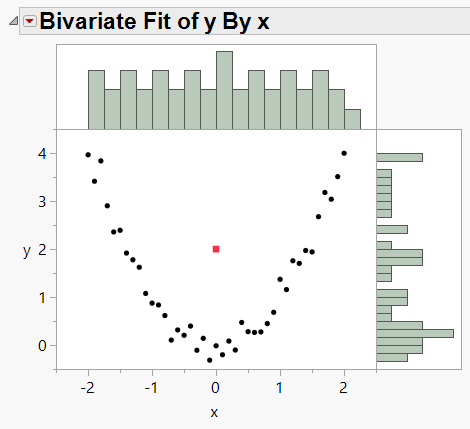

Example 5: A trickier two-dimensional outlier
Another odd outlier in two dimensions is shown in the figure below:
Figure 5: A trickier two-dimensional outlier.Figure 5: A trickier two-dimensional outlier.
Again, it is obvious to the eye, but more difficult to detect algorithmically. Still, there is a way! (See future blog posts.)
