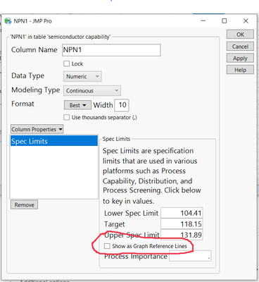

I assume the issue is that you have not selected the "Show Limits" in the Spec Limits Dialog window.
Jim

That would work for Spec Limits but it doesn't work for control limits. These are pre-calculated control limits that have been stored as column properties.
