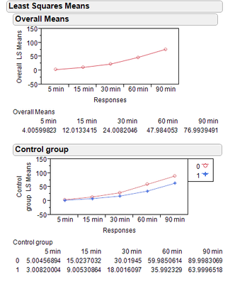

i have a data set of repeated measures yet the time interval between them is uneven (i.e. 5 min, 15 min, 30min, 60min from impact). when using the MANOVA platform the x axis doesn't allow any modifications. Thought of using the graph builder or the chart platform yet they do not allow labeling unevenly so i would have the indication of the actual times of measurement on the axis.

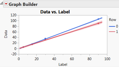

Ron,
Try doing a right click on that last table in your report, make it into a data table, then stack the time intervals.
I used graph builder for the figure above and marker spacing worked out ok.  Make sure your x-axis variable is numeric and continuous.
