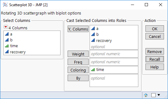

So, a few questions on what you are really trying to do. Would you want a, b, and recovery on the axes and the various time points "consolidated" on the same graph? Use Scatterplot 3D and drag a, b, and recovery to the Y, Columns role. This is similar to the script you saved in your example data, but it had "consolidated" points across b rather than time.

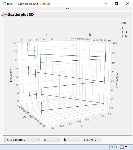

You don't have enough data to get a graph similar to the picture you showed.  Another possibility: set time as the coloring variable and you'll see all the points at once, with each time in a different color.  Also you can connect the points which will help somewhat.
Here are the steps.  Note that you have to change time to be ordinal.

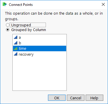

In the 3d scatterplot click the red triangle and select Connect Points

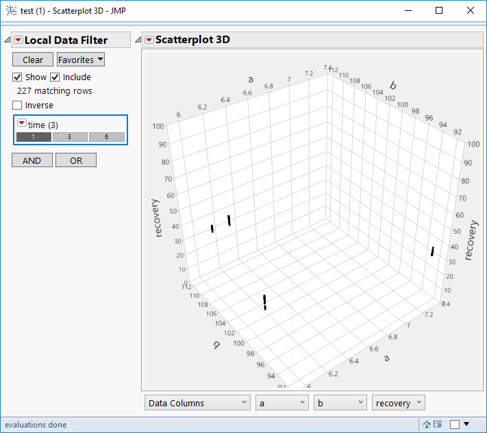

You could try the following:
1. Right click on the time column header and select Column Info.  Set the time column to be of type Numeric/Ordinal.  That will allow you to use discrete values of time.
2. Run the Scatterplot 3D and drag a, b, recovery to the Y, columns role.
3. Double click the Recovery axis and set the minimum to 0, max to 100.  This will insure that when you use the data filter the scales will not change
4. Click the red triangle and select Local Data Filter.
5. Select time.
Now you can click on the various values of time to cycle through the values.  You can click the Local Data Filter red triangle and select animation as well.
