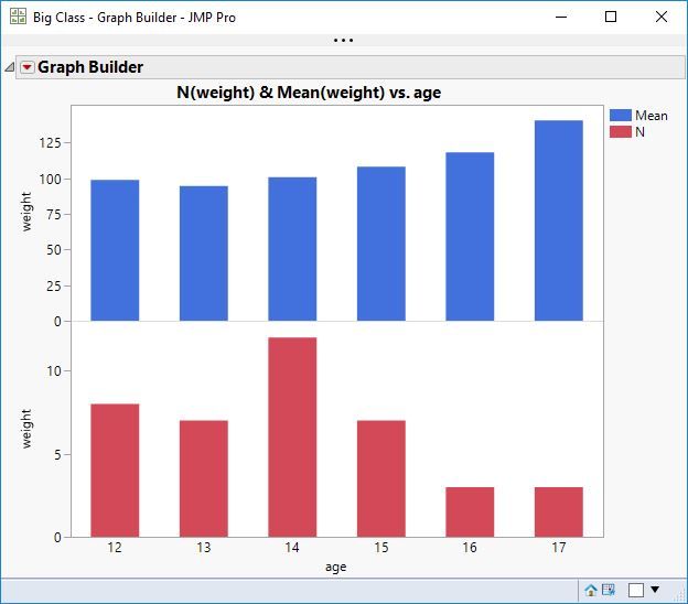

I do not know how to add such a label. You could, though, display the group size in a second plot.
This way would also allow you to use separate labels for the two kinds of information.
