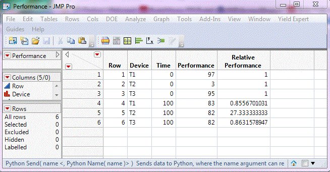

Here is a formula that will work.  I have also attached a data table with it applied.
dt = Current Data Table();
currentDevice = :Device;
:Performance / :Performance[(dt << get rows where( :Device == currentDevice & :Time == 0 ))[1]];
Jim

Hi all, I have the same question. However, I need a more reliable solution, I mean, not relying on row number, as my sheet can be mixed up.
So, is there a way to get the value from :performance of the row having the lowest value in :Time for each device, or even better: the value corresponding at Time=0 for each Device...
Maybe I'm not that clear...
Thank you
Nico

Very nice! Thank's
Just to understand, what is the function of [1] in the formula?
Nico
