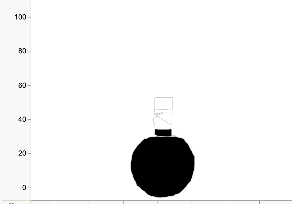

I am running a fundraising drive for a professional society, and we are trying to reach a goal of $10,000 in donations (no, this is not a shameless plug!). I am thinking plotting the data on a thermometer or something like this would look better than simply a bar graph. Screenshot 2022-11-01 at 09.02.36.pngI very poorly traced a portion of the thermometer using the "custom map shape" add-in (see attached files). Now, I can essentially turn off and on sections of the thermometer to show progress (likely binning by ~$1,000). But even if I meticulously trace this, I'm thinking it still won't look very good. My question is: am I over-thinking this? I'm thinking this might be a common-enough graphing goal that someone (a user or JMP employee) may have already developed a good graphic for showing "financial progress." Is there any sort of "custom shape" archive? I feel like I heard about this at one point! Well, I guess this may be more of a "graphmanship" question than a JMP question, but I am open to any suggestions of how to make a nice figure in JMP that will show progress towards an end goal (as it will be posted online, it would ideally support interactive HTML)! Screenshot 2022-11-01 at 10.14.02.png

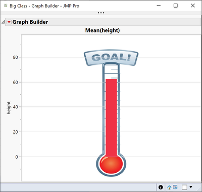

Perhaps use a background image rather than custom shapes.
Here is a theromometer image, with the data being plotted as a bar:
-Dave

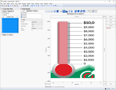

You might get some ideas from @scwise's JMP Community blog Scott's JMP Community blog . Also his "Pictures from the Gallery" series might give good ideas Community search - Pictures from the Gallery .
My first thought would be to use either Custom Graphics or background in graph builder and then combine that with Bar char and local data filter to control bar height.
Very very quick example:
-Jarmo

I figured there must be an easier way than tracing, so I'm glad I asked! That being said, I DID try and do a better job of tracing, and it didn't come out terrible (see shape files). Though that doesn't address the scale issue so I simply used "annotate" to cheat.Screenshot 2022-11-02 at 07.30.38.pngI will check out Scott's suggested posts. I am always looking for better ways to present data, though in this case, maybe the relatively more drab option isn't necessarily that bad: ICRS fundraising drive.jmp - Graph Builder.pngThis one took all of 10 seconds to make in GraphBuilder and (hopefully) shows that we are progressing towards our goal. So maybe for this particular example, the simple default option shouldn't necessarily be frowned upon, whereas for other purposes, more advanced, customized, "sexier" options may be the way to go, so I'll check out these resources to see how I can improve my "graphsmanship" with JMP Pro 17+GB! Thanks everyone.
