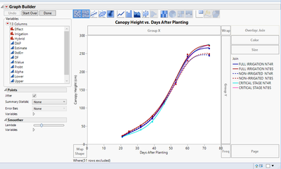

I have an output SAS data set consisting of multivariate lsmeans and their upper and lower CIs. I can plot the means in graph builder however I need to add the confidence intervals for each mean. Is there a way to do this in JMP? The lsmeans are from a repeated measures analysis using PROC MIXED. I know JMP has the ability to do mixed models but my knowledge of how to translate the SAS model/repeated/random code exactly in JMP is still a bit sketchy.

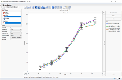

Is this what you are looking for?
Here is the script that is generated from the above display:
Graph Builder(
  Variables(
  X( :DAP ),
  Y( :Estimate ),
  Y( :Lower, Position( 1 ) ),
  Y( :Upper, Position( 1 ) )
  Elements( Line( X, Y( 1 ), Y( 2 ), Y( 3 ), Legend( 31 ) ) )
Jim

Sorry for not being more explicit in how I was plotting the data, but the attached JMP graph selects the variable 'estimate' for the Y-axis (=Canopy Height), DAP for the X-axis, and the variable "Join" is overlaid. I want to create vertical CI bars for each of six mean point data across DAP. The curve lines are only for approximating the shape and are not derived from the mixed model information. Is there is way to code the CI information back into the graph builder script to achieve this?
Thanks!

Thank you so much for the jsl code. That is what I was aiming for, although the tightly clustered means for this particular data are not really well differentiated by CI bars. Going further, is there code to (1) specify the width of the horizontal fence, and (2) specify color of the bars? An example would suffice, I can edit the code as needed.
Thank you for your excellent help!
txnelson
Re: plotting confidence intervals output via SAS lsmeans
All you have to do to control the Line Size is to use the Pen Size(); function.
And for the color, you use Pen Color();
You can look up examples in
    Help==>Scripting Index
Just type in to the search field, Pen Size or Pen Color
And Karen's solution is "Very Cool"!
Jim
