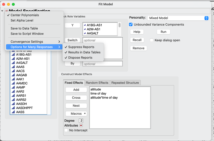

If you wanted to stick with the mixed model approach with repeated measures, I guess you could do PCA on the mRNA, save the largest impact PCs and then use those in the response role (kinda like what PLS will do). Then do the repeated measures as one might do in Mixed Models or Standard least squares like in this tutorial.
Or put all of the mRNA in response, choose mixed model, set it up as one would for a time based repeated structure and then put treatment in to Fixed Effects (I am probably missing something to add). Then use the red triangle and choose Options for Many Responses. You will get a table for everything instead of a report and that might help, but then there will be some extra work to sort out which mRNA is most affected and other stats for each of the model terms.
It's a thought anyway. Might be worth it.

eclaassen
Staff
Re: multivariate data with a repeated measures design
I was just going to come back in and reply with this, but you beat me to it. (I didn't see this reply before I replied yesterday, so I wonder if we were typing at the same time, @Chris_Kirchberg !)
This is a great option because you can then plot/sort the test p-values to see which are significant, etc. And with JMPs interactivity, you can select on the plots and it selects in the data table for subsetting out the "important" ones. This is how I've seen most 'omics-type analyses that have more complex random effects structures. Yes, it's ignoring the correlation between the Ys, but it makes the analysis feasible, whereas otherwise it's intractable.
