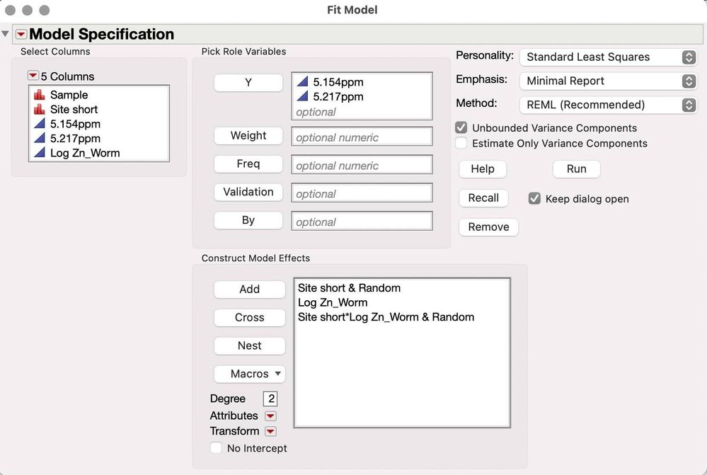

I am trying to model the effect on metabolites as a mixed effects model, using the Fit Model menu, with "metal" as a fixed effect, and "site" and "site x metal" as random effects ("metal" and "metabolite" are continuous variables, "site" is categorical).
Now, here is my question. For some metabolites, the JMP output gives me what I am looking for, a significance test ("fixed effect test") for the effect of metal ion on metabolite concentration, BUT for some other metabolites, it does not calculate a value, and just gives "." Any suggestions as to what is going on? There are no missing values, so the number of samples and variables is identical - it is just that it gives me an answer for some dependent variables and not others.

Can you also share the JMP platform (as a picture)? It might be that you specified the model in a way that confounds some effects.
Yes, I'll give that a go, thanks - hopefully this is what you meant, a screenshot of the relevant options chosen?
NB that for me, the two Y variables shown have different outcomes, in that JMP successfully calculates a P value for one but not the other.
