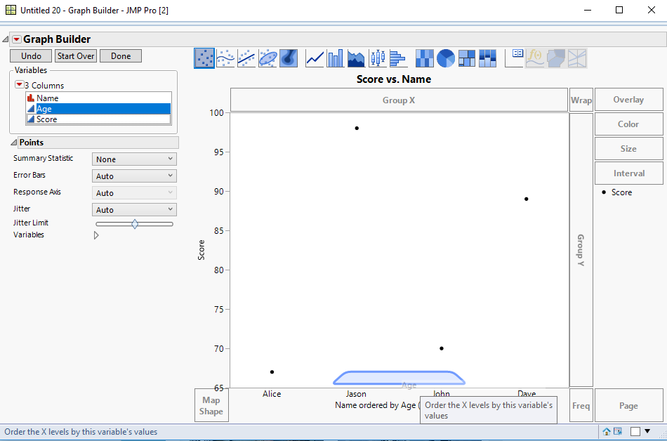

txnelson
Re: how to sort x axis by another column value
When using Graph Builder, all that has to be done, is to drag the variable you want to order your axis by, to the Order By area for the Axis, as shown below
Or you can sort the data table by the sort variable(Age), and then set the Column Property, Row Order Levels for the column Name, and then the order used for the Name variable axis will be the order the Names are found in the data table.

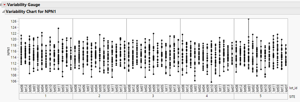

AdamChoen
Level IV
Sorry, the Sex group example is not so good since it has few (or no) similar names on each group.
here is the same example based on the semiconductor table:
dt = Open("$SAMPLE_DATA/Semiconductor Capability.jmp");
// Set value ordering to :name after mean :age
Summarize( g = by( :lot_id ), m = Mean( :PNP1 ) );
:lot_id << Set Property( "Value Ordering", Eval( g[Rank Index( m )] ) );
// Variability chart with names grouped by sex ordered after age
Variability Chart(Y(:NPN1), X(:SITE, :lot_id));
it results with the below Var chart (all SITE has same lot_id order) - which is wrong I believe.
How can I plot the lot_id order by PNP1 for every SITE in Var chart using jsl.
Hope I made my request clearer.
I prefer using
Variability Chart(Y(:NPN1), X(:SITE), By (:lot_id));
and not
Also, the statement that I can do this using graph builder from my previous replay here is wrong, I see that now.
Thank you.
Thanks, Adam

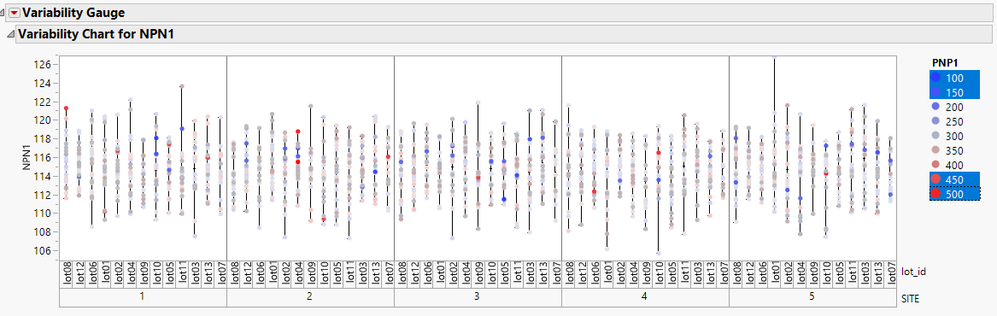

AdamChoen
Level IV
I think creating a concat column will do the trick as follow
dt << New Column("lotID by Site", Character, Formula(char(:SITE)||"_"||:lot_id) );
Summarize( g = by( :Name("lotID by Site") ), m = Mean( :PNP1 ) );
:Name("lotID by Site")  << Set Property( "Value Ordering", Eval( g[Rank Index( m )] ) );
Variability Chart(Y(:NPN1), X(:Name("lotID by Site")), by (:SITE));
if anyone can share a more elegant solution I will appreciate it.
Thanks, Adam
