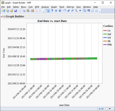

Hi all,
I have a data table that presents a sequence over time and records only when there is a change (un equal time intervals).
I would like to produce a graph with time on the horizontal axis and parallel horizontal lines representing the three categorical variables (place, condition and condition 2).
The colors along the lines will represent the different categories of place and conditions.
I manage to produce a somewhat fake presentation by setting start time as X and end time as Y, connecting with a line, coloring by category and compressing the Y axis so the line looks horizontal.
attached is the data table with two scripts to run.
I would be very thankful for any suggestions,
Thanks,
Ron

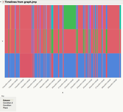

FWIW, I wrote the attached script, which generates this kind of plot (basically a 'Cell Plot' with a proportionate time axis):
No doubt it could be much improved, but it's a start if anyone has the inclination to do more. I've also attached a modified version of the data from ron_horne​.

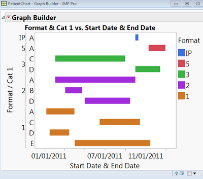

Re: making a graph of a sequence
Hi Ron,
See the image below and let me know if this is more like what you are looking for or not.

ron_horne
Super User (Alumni)
hi bill,
this is quite close since it allows "Format" categories to start and end multiple times. do you think it is possible to show in one bar various starting and ending points of the same category?

ian_jmp
Level X
ron_horne
Super User (Alumni)
thank you Ian@JMP​,
this is an outstanding contribution and just what i need.
ron
