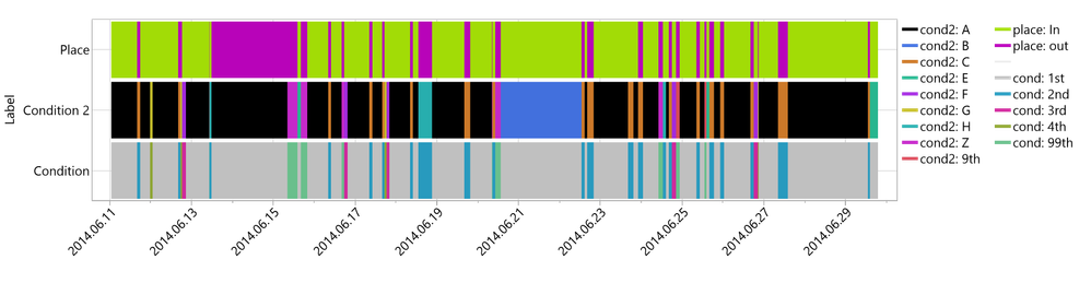

hi Bill,
This is the file. It has a stat date, end date, duration in minutes and three categorical columns.
it looks like this. the truth is the graph i seek would look very similar apart that the length of the colors would be proportional to the duration.
do you think it would be useful to inflate the file (rows) by duration first? (as in this link: Expand by Frequency Column Add-In )
thanks!

jerry_cooper
Staff (Retired)
Re: making a graph of a sequence
Hi Ron,
I was able to generate the below chart by creating two new formula columns. The first column is a sequence that increases by one each time the Place entry switches I called it Place Group. Then a second column was created using Col Sum for Place Duration with Place Group as the Group By variable. Change the Place Group Modeling Type to Nominal.  Then, in Graph Builder, put the place duration on the X-axis and switch to a bar chart, put Place Group in the overlay zone, and Place in the color zone. Switch the Bar type to stacked and leave Mean as the summary statistic:
This will work for the other two conditions, as well, but, I think you will need to do separate graphs... maybe you can combine them in one window...
I've attached the jmp file with the new columns and Graph Builder scripts. Hope that gets you closer to what you're wanting to do.
-Jerry

hogi
Level XIII
Since JMP19 (with the new setting:  within row), this type of plots is very easy now in JMP:
https://community.jmp.com/t5/Discussions/How-do-I-make-start-stop-bar-charts/m-p/913541/highlight/tr...
stack the 3 columns of interest, use Label on the Y axis,  start Date and end Date on the X axis and Data as Color:
Data Table( "graph" ) << Stack(
	columns( :Place, :Condition, :Condition 2 )
Graph Builder(
	Size( 1110, 347 ),
	Show Control Panel( 0 ),
	Variables( X( :start Date ), X( :End Date, Position( 1 ) ), Y( :Label ), Color( :Data ) ),
	Elements( Line( X( 1 ), X( 2 ), Y, Ordering( "Within Row" ) ) )
