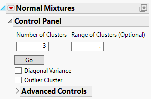

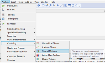

The "Normal Mixtures" platform does Latent Profile Analysis. You can find it under Analyze > Clustering,
After selecting the variables you want to use to launch the platform, you'll find a Control Panel that allows you to select the range of clusters to extract so you can compare their fit (based on BIC or AICc) and decide which is best,
You should consider whether you want to restrict the covariances between variables to be zero. If you do, you should check the "Diagonal Variance" box. Doing so often helps with model estimation (depending on the data). The Advanced Controls allow you to change the number of random starts (Tours) to make sure you don't land on a local solution.

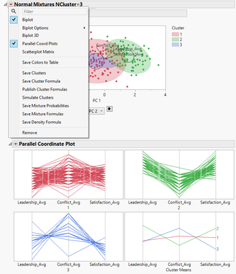

Once you have the cluster solutions, you'll find it useful to look at biplots and Parallel Coordinate Plots using the red triangle menu options,

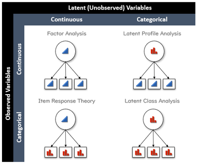

Unfortunately, Latent Profile Analysis still wouldn't come up here (but I'll pass that feedback to make sure it does in the future!). We generally try to use multiple terms in the description of stat techniques so that this Search JMP engine will find them.  Search JMP is a great feature because it'll also show you exactly how to access what you're looking for. Of course, the JMP Community is also a great tool to ask your questions and get the answers you need =).
As far as the image I pasted, it's one I made a while back to explain these concepts in a blog post. You can find it here if you scroll down to the comments:
https://community.jmp.com/t5/JMP-Blog/Principal-components-or-factor-analysis/ba-p/38347

Thank you so much for the explanation and instructions. This is exactly what I was looking/hoping for. I first tried imputing continuous variables in the LCA platform, but it wouldn't take of course, which had me worried. And I kept turning up a blank when searching for the term latent profile analysis. Chat GPT told me it was there, but was probably called something else. Thanks for showing me where. I wonder if there is a type of glossary maintained by JMP that equates the many different names of analyses and specifies which one JMP uses. Or, could you show me where the image you posted comes from? Is this a JMP diagram/map? Many thanks.

IMO, your best bet for finding analyses in JMP that might have different names is to look under Search JMP in the Help menu,
