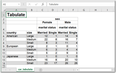

gzmorgan0
Super User (Alumni)
Re: jmp tabulate to excel
This is an extension of Peter Bartell's suggestion: save the journal as HTML.  This script adds the JSL that uses Run Program() with wscript  (that runs vbscript) to import the saved HTML file and do some formatting.  It is a modification of example #3 in the script 9_RunProgram.jsl from JSL Companion, Applications of the JMP Scripting Language, 2nd edition.
The script is attached.

 Here is a screen shot of the Excel file. It is a standard Excel file with merged cells for row and column headers and values in  cells.
