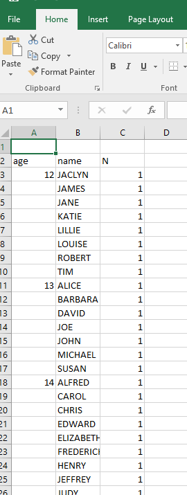

Re: jmp tabulate to excel
You can save the Tabulate output to a text file, which you can then bring into Excel.  Here is a simple illustration of saving the output to text
Names Default To Here( 1 );
dt = Open( "$SAMPLE_DATA/big class.jmp" );
tab = tb = Tabulate(
	Show Control Panel( 0 ),
	Add Table( Row Table( Grouping Columns( :age, :name ) ) ),
	Display Column Width( Row Label( "name" ), 70 )
Report( tb )[tabulatebox( 1 )] << save text( "$TEMP/tab.txt" );
Jim

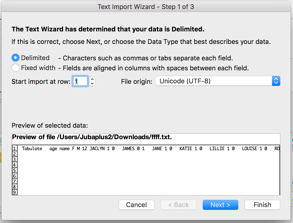

joann
Level IV
Thank you Jim.
This might be a stupid question, but how do I open the txt correctly in excel with the original tabulate format? I opened it with excel but it appeared in only the first row, no the right format.

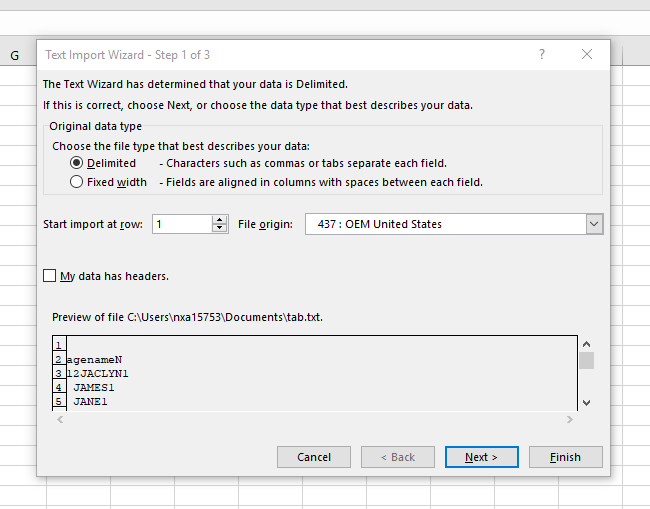

txnelson
I opened Excel, then went to File==>Open, and browsed to the text file.  Selected it and when the file was attempting to open, it brought up the Text Impor Wizard.
and it then opened the file
Jim
joann
Level IV
Hi Jim,
I opened the excel wizard, but mine looks different from yours as attached. And I don't have the 437 origin like you did. However I managed to paste it to Notes first and then paste it to excel and it worked. Thank you very much!
