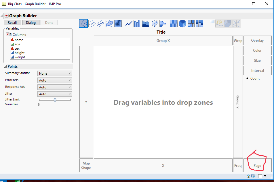

Thanks Jim, but could you please show where is the Page area?
txnelson
Re: how to plot an overlay variability chart
Assuming you are running JMP version 12 or later, here is where the Page drop area is
Jim

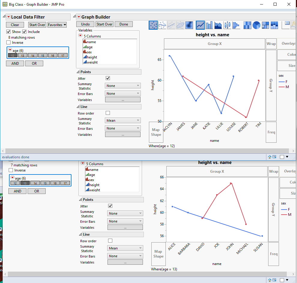

txnelson
You can run the Graph Builder platform twice and within each run, add a Local Data Filter, and only select Class 1 for the first instance of Graph Builder, and selec Class 2 for the second instance.  Here is an example using the Big Class Sample data table, and using the variable Age instead of the variable Class.localfilter.PNG
Jim
