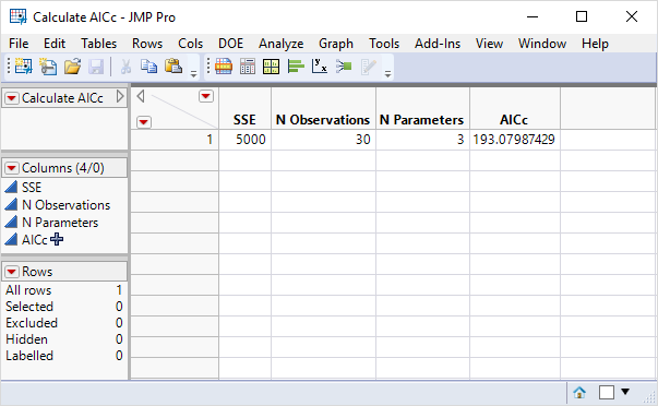

I am sorry that you are annoyed. Perhaps this data table will help with calculating the AICc for your models:

Thank you for your help Mark. Is it possible to add an option to automatically obtain AICc (and BIC) in "nonlinears" to the next JMP versions?
