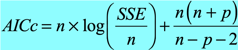

How can I get AIC values for a self created nonlinear model (by column formula)?
I choose Analyse > Specialized modeling > Nonlinear , I put my formula column as X, the response column as Y, I get convergence. But how can I get AIC values to compare the model with a linear model? Or are there other ways to compare my formula model with a linear one?

You can calculate the AICc for the continuous response using this formula:
Where n = sample size, p = number of model parameters, and SSE for the fitted model. The log() is the natural logarithm function.
