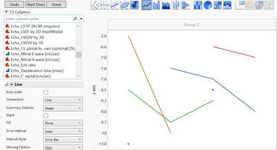

how can i edit y axis in graph builder?
Hi,
I have negative values that I am trying to adjust in graph builder. How can I edit this graph to go from 0 to -15 with automatic ticks to space the data accordingly? I don't understand how jmp is using the min and max to come up with the scale.

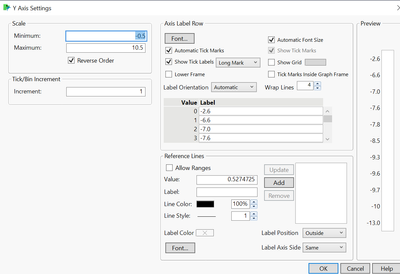

You might have incorrect modeling type (nominal/ordinal instead of continuous) or even incorrect data type (character instead of numeric).
-Jarmo
