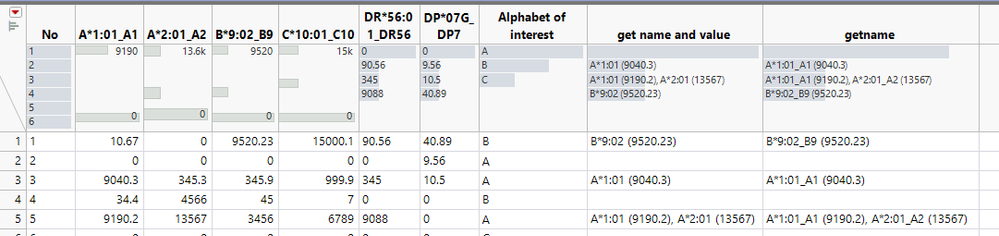

colnames = Remove(dt << Get Column Names("String"), 1); // drop No column
// Fix data and modeling types
For Each({colname}, colnames,
	Column(dt, colname) << Data Type("Numeric") << Modeling Type("Continuous");
newcol = dt << New Column("getname", Character, Nominal, Formula(
	valid_idx = Loc(dt[Row(), colnames] > 1000);
	If(N Items(valid_idx) > 0,
		Concat Items(colnames[valid_idx], ", ")
dt << run formulas;
newcol << delete formula;

Most likely doing something like Jim suggested is faster and easier, but you can do something like this with the method I did demonstrate
Names Default To Here(1);
dt = Open("$DOWNLOADS/Examples_get column name_by cutoff.jmp", invisible);
Summarize(dt, alphs = By(:"Alphabet of interest"n));
aa = Associative Array(alphs, Repeat({{}}, N Items(alphs)));
collist = dt << Get Column Names("String");
For Each({colname}, collist,
	alph = Word(1, colname, "*");
	If(Contains(aa, alph),
		Insert Into(aa[alph], colname);
		Column(dt, colname) << Set Data Type("Numeric") << Modeling Type("Continuous");
str_template = "^col^ (^val^)";
	cols = aa[:"Alphabet of interest"n];
	vals = dt[Row(), aa[:"Alphabet of interest"n]];
	valid_idx = Loc(vals > 1000);
		res = {};
		For Each({{col, val}}, Across(cols[valid_idx], vals[valid_idx]),
			Insert Into(res, Eval Insert(str_template));
		Concat Items(res, ", ");
dt << run formulas;
dt << show window(1);
-Jarmo

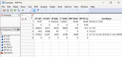

txnelson
Re: getting column name with specific cut-off values
Here is how I would handle this
names default to here(1);
dt = New Table( "Example",
	Add Rows( 6 ),
	New Column( "A*1:01",
		Numeric,
		"Continuous",
		Format( "Best", 12 ),
		Set Values(
			[10.67, 0, 9040.2999999999993, 34.399999999999999, 9190.2000000000007, 0
	New Column( "A*2:01",
		Numeric,
		"Continuous",
		Set Values( [0, 0, 345.30000000000001, 4566, 13567, 0] )
	New Column( "B*9:02",
		Numeric,
		"Continuous",
		Set Values( [9520.2299999999996, 0, 345.89999999999998, 45, 3456, 0] )
	New Column( "C*10:01",
		Numeric,
		"Continuous",
		Set Values( [15000.1, 0, 999.89999999999998, 7, 6789, 0] )
	New Column( "DR*56:01",
		Numeric,
		"Continuous",
		Set Values( [90.560000000000002, 0, 345, 0, 9088, 0] )
	New Column( "DP*07_G",
		Numeric,
		"Continuous",
		Set Values( [40.890000000000001, 9.5600000000000005, 10.5, 0, 0, 0] )
dt << New Column( "Get Name",character);
colNames = dt << get column names( continuous,string );
For Each Row(
	theList = {};
	For Each( {col, i}, colNames,
		If( As Column( col ) > 3000,
			Insert Into( theList, col )
	:Get Name = Concat Items( theList, "," );
Jim

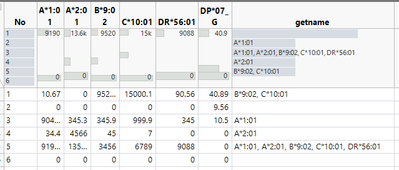

jthi
This might be fast enough
// Create a sample data table
dt = New Table("Example",
	Add Rows(20000),
	invisible
colcount = 200;
For(i = 1, i <= colcount, i++,
	newcol = dt << New Column(Char(i), Numeric, Continuous, Formula(
		Random Normal() * 1000
	dt << run formulas;
start = Tick Seconds();
colnames = dt << Get Column Names("String");
dt << run formulas;
wait(0);
end = Tick Seconds();
show(end - start);
-Jarmo

jthi
My script creates new column "getname" with the values
With your data, after you fix your columns to numeric (and drop No column)
-Jarmo
For(i = 1, i < 100, i++,
	newcol = dt << New Column(Hex(i), Numeric, Nominal, Values(J(1, N Rows(dt), Random Normal()*1000)));
dt << run formulas;
