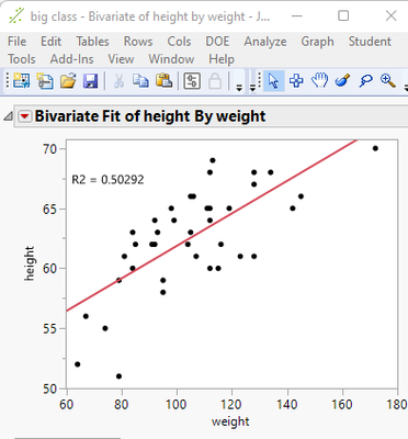

Here is a simple example.

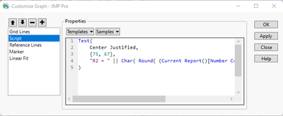

I developed it interactively by using the  Customize Graph designer dialog box available by right clicking on the graph and selecting "Customize".
Once I developed the code, using the Text Template, I then had JMP generate the complete JSL, see below.
Names Default To Here( 1 );
dt = Open( "$SAMPLE_DATA/big class.jmp" );
Bivariate(
	Y( :height ),
	X( :weight ),
	Fit Line( {Line Color( {212, 73, 88} )} ),
	SendToReport(
		Dispatch(
			"Bivar Plot",
			FrameBox,
			{Add Graphics Script(
				4,
				Description( "" ),
				Text(
					Center Justified,
					{75, 67},
					"R2 = " || Char( Round( (Current Report()[Number Col Box( 1 )] << get)[1], 5 ) )
Jim

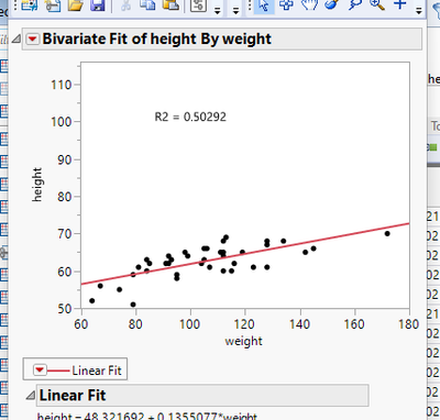

Hi Jim, Thanks, it works, but encounter another problem: I'd like to use variables in the "{75, 67}," i.e. the position but seems the variables cannot be passed into the function. I need to use variable instead of fixed value because the text position should depend on x/y scale, which differs chart by chart.
Something like this: the my_pos_lst seems cannot be successfully fed into the function. Do you have any idea? Thanks!!

txnelson
Re: fit y by x question: show equation on chart
It works for me
It just isn't in the default range for the chart, so I had to scroll up to 100 on the Y axis to see it
Jim
