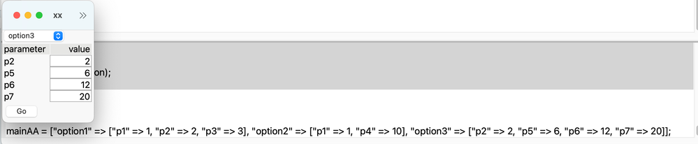

Names Default To Here( 1 );
AAopt1 = Associative Array( Words( "p1,p2,p3", "," ), {1, 2, 3} );
AAopt2 = Associative Array( Words( "p1,p4", "," ), {1, 10} );
AAopt3 = Associative Array( Words( "p2,p5,p6,p7", "," ), {2, 6, 12, 20} );
MainAA = Associative Array( Words( "option1,option2,option3", "," ), Eval List( {AAopt1, AAopt2, AAopt3} ) );
nw = New Window( "xx",
	V List Box(
		cb = Combo Box(
			mainAA << get keys,
			Try( TB << delete );
			tableVLB << append(
				tb = Table Box(
					TbSCB = String Col Box( "parameter", mainAA[cb << get selected] << Get Keys ),
					TbNCEB = Number Col Edit Box( "value", mainAA[cb << get selected] << Get Values )
		tableVLB = V List Box(),
		bb = Button Box( "Go",
			mainAA[cb << get selected] = Associative Array( TbSCB << get, TbNCEB << get );
			Show( mainAA );
eval(cb << get function);

Re: Update the content of a DisplayBox with an Associate Array when the selection of a ComboBox changes ?
You can make the dialog modal, as below.
To make a recall function, you will need to prevent re-initializing the AAs each time the window is opened, by initializing the AAs in another part of the code, that can be separated from the code used to show the window.
Each time the OK button is pressed, in addition to saving the new values to the appropriate AA as is already done, you can save the settings off to global (or, preferably, scoped) variables, and use these variables' values to populate the dialog the next time "recall" is pressed.
nw = New Window( "xx", <<modal, << on open(eval(cb << get function) ),
	V List Box(
		cb = Combo Box(
			mainAA << get keys,
			tableVLB << append(
				tb = Table Box(
		buttonbox("OK",
			Show( mainAA );
