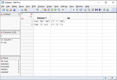

still having issue. The suggestion will only match first element in mylist to first element in :Column 1. Then second to second and third to third. Also if :column 1 has more than 3 elements, the rest will be removed. Below is the result from suggestion
how to enable below.

There was one mistake in my example and I understood incorrectly what you were looking for. This is most likely closer to what you are looking for
Names Default To Here(1);
dt = New Table("Untitled",
	Add Rows(1),
	Compress File When Saved(1),
	New Column("Column 1",
		Expression,
		"None",
		Set Values({{"aa", "bb", "dd"}, {"bb", "2", "cc"}})
mylist = {"aa", "bb", "cc"};
dt << New Column("res", Expression, "None");
For Each Row(
	dt,
	rowresult = Transform Each({item}, :Column 1[Row()],
		If(Contains(mylist, item),
			"1"
			item
	:res = rowresult;
-Jarmo
