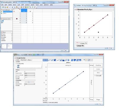

excluded_points.jpgexcluded_points.jpgThe attached example shows a number of data points where the fourth is "excluded".
When plotting the data using the fit X by Y platform the result is as epxected (the fourth data point is on the plot but not taken into account for the fit). However, when using the "Graph builder" the point does not appear on the plot which seems unexpected. Why are the plots different?

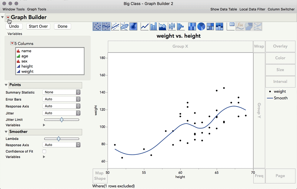

It's been some time since you posted, but your post was mentioned in another discussion just recently. In case it's still helpful, I wanted to let you know that there is a hidden option to show excluded rows in Graph Builder: while holding shift, click the Red Triangle > Show Excluded Rows. The excluded rows will now show on your plot as slightly transparent.

@jules - THANKS for this! I am generally pretty good about remembering to use shift to find hidden options, but had missed this one and just had an application where a user wanted to gather data from an entire part for various reasons, but only gather statistics on the 'region of interest'. This is perfect!
