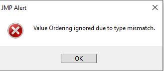

hi,
I have this message when I used a data filter:
what doest it means ?
best regards
1 REPLY 1
hogi
Level XIII

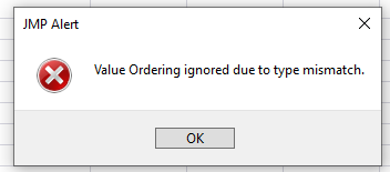

Re: error message
Most probably you changed the Modeling Type of a column which had some Value Order info.
In the example below, there a value order is defined for numeric height values, then the modeling type for height is changed to character.
This triggers the error message:
Open( "$SAMPLE_DATA/Big Class.jmp" );
Data Table( "Big Class" ):height << Set Property(
	"Value Order",
	{Custom Order(
		{56, 51, 52, 55, 68, 69, 70}
	), Common Order( 0 )}
Data Table( "Big Class" ):height << Data Type( Character ) <<
Set Modeling Type( "Nominal" );
