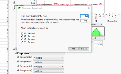

I thought "Monte Calro Simulation" is same with the simulation experiment in below pic.

Yes, "Simulation Experiment" is based on the Monte-Carlo simulations, and it give you only a subset of all possible values of your experimental space, based on the portion of experimental space you specify (and the number of points).
More infos here : Simulation Experiment (jmp.com)
But you also have the possibility to check graphically the impact of variability of your inputs (and possible noise in the response(s)) directly in the Profiler, by clicking on "Simulate" button, next (on the right) to the Desirability case on your screenshot.

Fixed : Fixes the factor at the current value in the profiler for all simulation runs. (from : Simulation Settings for Factors (jmp.com))
So it means that in the computations, a portion of single values will be used in all simulations, depending on the portion of factor space you're specifying. There will be no random variations added for the "fixed" factors, so computations will be done directly using the model from the Profiler.
For example in the example JMP datatable "2x3x4 Factorial", if I fix all factors and use "Simulation Experiment" and specify 128 runs and portions of factor space 0,5 then JMP will create 128 runs with continuous factor X1 in the range of -0,5 to 0,5 (instead of full factor range -1 to 1) and will test all levels for the categorical factors. But no random variations is added, so all computations are done with the model found before (completely deterministic outcome).
Between Simulation Experiment with fixed factor and Random Uniform factor, the difference will be in the output of the table and levels of the factor used. The "Simulation Experiment" platform uses a Latin Hypercube, so different levels will be chosen and approximately same number of experiments will be done for each levels. This is not necessarily the case with the "Random Uniform" factor option, since this process will be ... random. You can compare the two tables on the JMP dataset to see the differences (same number of runs, one table created with Simulation Experiment, the other with Random Uniform factor X1) or look at the images provided showing you the different distributions for X1 depending on which option you choose (Random Uniform on X1 or Simulation Experiment).
