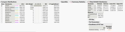

I am doing cpk analysis and did continuous fit-->fit all to find the true distribution for the data, then run cpk. JMP provided the best option, then I did Goodness of fit to confirm by P-value, however, P <0.001 which reject the distribution JMP suggested. I assume, this means JMP do not have the proper distribution stored. My question is if I can just use the distribution to run CPK, based on the lowest AICc in JMP? Or what will be the option here for me to get correct CPK? Thanks.

Re: distribution of the data is not in JMP during CPK analysis
I attached the pic in the original post. I may wrong. The attached pic showed that JMP selected SHASH as the best fit, but goodness of fit p value is <0.001. My understanding is this p reject the hypnosis of SHASH is the distribution. the overlay seems good fit and qq plots seems good too, but I don't get it why P values is so low.

The pictures that @Mark_Bailey is looking for would be extremely helpful. As he stated, the small p-value could be caused by an outlier. The pictures will help determine that. Also, how many observations do you have? With enough data, any small discrepancy that is not of any practical significance could be flagged as statistically significant. Again, the pictures that Mark is asking for will help determine that, too.

I have over 1k obs, just the natural of the data is one peak followed by a skinny tail.

These tests for goodness of fit are notoriously sensitive when the amount of data is large. The idea is simply that real data, in large quantities, rarely follow an idealistic distribution model. Even large quantities of data from sampling a ideal population (e.g., random number generator for a given distribution) will often find a statistical significant departure from the model, which is a type I error.

The plots (i.e., histogram and quantile plot) are not visible in either of the pictures that you provided.
