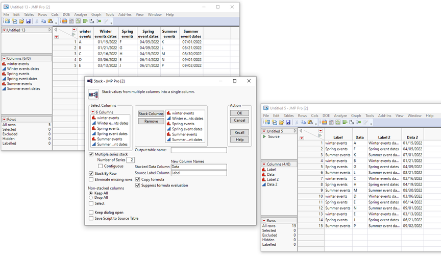

I suspect that you mistakenly specified the "Number in the Series" incorrectly.  It should be specified as 2.  See below

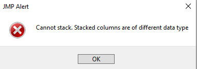

I tried the stack function with multiple series, it seems to not work as my columns are different data type:

Thank you! It works
