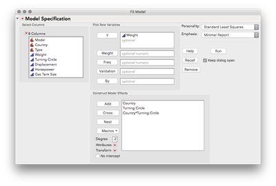

If I'm understanding your question correctly, you have a regression with a categorical variable (X1) and continuous variable (X2) and the interaction between them predicting a continuous variable (Y). Your categorical variable (X1) has more than two levels, and you have a statistically significant interaction between X1 and X2 and would like to follow-up on that to see for which groups the regression of Y on to X2 differs. The methods listed by others here don't seem to be testing the pairwise differences in slopes, but rather the pairwise difference in means, assuming a mean level on the continuous regressor (X2).  There is a way to get the tests you want, but it'll take a few extra steps. I'll use the Car Physical Data sample dataset for this example.
First I will fit a model like you're working with. I predict Weight on the basis of Country and Turning circle, and their interaction.

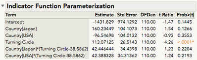

To reveal a test of slopes, we will go to the top-most Red Triangle > Estimates > Indicator Parameterization Estimates
This will show a table of parameter estimates based on an indicator parameterization (as opposed to effects coding, which is what the regular parameter estimates table is based on) which means the LAST level of your categorical factor is used as a reference category, and estimates are differences from that reference category. This will be useful for us.
Notice that we see no estimates with USA. That's because USA is our reference category, so all estimates are differences from what was estimated for the USA.  Country[Japan], with the estimate of 256.78, is how much Japan differs from the USA in terms of weight on average. Notice that is the same thing we saw above in the ordered differences report table.
If we look at the interaction parameter estimates we can use the same logic: Country[Japan]*(Turning Circle-38.5862), and the associated estimates, is how the slope for Japan differs from the slope for the USA (by the way, the slope for the USA is listed under "Turning Circle" since it's the reference category, so 155.46 is the USA).  Notice that the slope for Japan is nearly the same as the slope for the USA -- different by only a value of 0.06, p = 0.9985. The slope for Other differs from the USA by -42.38, p = 0.2193.
So we're almost there. We're missing one test, Japan vs Other. To get this we need to make JMP treat Japan, or Other, as the reference category, and then rerun this analysis. I'm going to choose to treat Other as the reference category. To change the reference category we'll change the Value Ordering property for the column Country. Right click on the column in the table and go to Column Info. Click on Column Properties, and then select Value Ordering. To change the ordering, select "Other" and click Move Down. The last category listed will be the reference category.  Click okay when you're done.

The "Indicator Function Parameterization" now lists the same analyses we saw before, but with "Other" as the reference category.
And now we have our last test, the slope difference between Japan vs Other, which we find in the row "Country[Japan]*(Turning Circle-38.5862)".  A difference of 42.45, p = 0.2204.
So we have our three pairwise slope tests.
Japan vs USA, difference = 0.06, p = 0.9985.
Other vs USA, difference = 42.38,  p = 0.2193.
Japan vs Other, difference = 42.45, p = 0.2204.

I didn't understand the difference between the regular parameter estimates
and the indicator function parametrization estimates. Nor do I understand
the role of the constant (38.5862) subtracted from the continuous
predictor (turning circle) in obtaining the estimates. When using SAS and
the ESTIMATE statement in PROC GLM one can get an estimate of the
regression slope for each value of the categorical variable. How can I get
these values in JMP?

  • Difference between regular parameter estimates and the indicator parameter estimates: This has to do with how JMP parameterizes categorical variables. There are two ways to do this: effect coding, and indicator coding. Effect coding, common in designed experiments, models the parameters such that the estimates are with respect the grand mean across all groups. So, the regular parameter estimates list a difference from average response. Indicator coding means that estimates reflect a difference from some baseline or reference group. Both types of parameterization are useful at times, but effect coding, the default in JMP, has better properties for more complicated models and is thus prefered.
  • The naming of the interaction terms with subtracting a constant: this is called centering, or using a centered polynomial. That constant is the mean of that variable, and in constructing the interaction term the cross product between variables is found my multiplying not the original values of the variable, but the value of the variable after subtracting the mean. This also has desirable properties for complicated models, and has the useful effect of keeping lower order terms in the model more interpretable. In short, the parameter estimates of lower order terms, say of Japan vs USA in terms of weight, indicate how much those countries differ for cars of average turning circle. Without centering of the turning circle variable, that lower order term would indicate the estimate when cars have 0 turning circle radius (which doesn't really make any sense).  For more information about centering a polynomial and its consequences, see my response and video on this post: estimates in multipule regression
  • There are a few ways to get the slopes for each group. Using the indicator parameterization table you can just look at the estimate for your continuous variable, and that will be the estimate for the slope of the reference category.  Another way is using Analyze > Fit Y by X.  Set this up with just your continuous Y and continuous X, click okay, then once you have the output go to the Red Triangle > Group by, and then select your categorical variable. Now, whatever action you perform will be done separately for each X. Go back to the Red Triangle > Fit Line. You will now have as many linear fits as you have levels of your categorical X. You can read off the individual slopes there.
