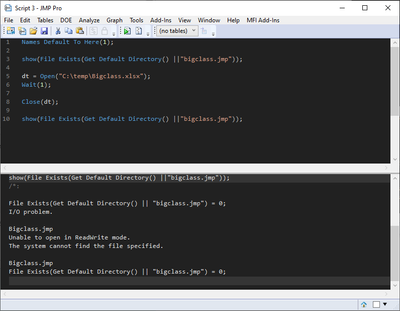

I can replicate this behaviour with JMP17.0. The file will be saved to Current Default Directory().
Names Default To Here(1);
show(File Exists(Get Default Directory() ||"bigclass.jmp"));
dt = Open("C:\temp\Bigclass.xlsx");
Wait(1);
Close(dt);
JMP17.0
This behaviour has been different in earlier JMP versions, but I wouldn't say that it is was to No Save as it gives message to log where as using No Save doesn't
JMP16.2
-Jarmo
