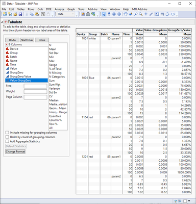

I think you will have to add couple of formulas and then you can create tabulate/summary table like this
I would create a column to calculate the Zero value. Depending on your data something simpler (or more complicated) could be used
Col Mean(
	If(Col Min(:Time, :Device, :Group, :Batch, :Name) == :Time,
		:Value,
Then create the calculation columns
:Value / :GroupZero - 1
and
:Value - :GroupZero
Below is the script JMP created to me (I would clean it up a lot and make it more robust)

// Report snapshot: Data - Tabulate
Tabulate(
	Show Control Panel(0),
	Add Table(
		Column Table(Analysis Columns(:Value), Statistics(Mean)),
		Column Table(Analysis Columns(:Diff to 0, :Diff to 0perc), Statistics(Mean)),
		Row Table(Grouping Columns(:Device, :Group, :Batch, :Name, :Time))
-Jarmo

Wow! Thank you Jarmo!
I´d never guess that Col Mean could be used in that way...
If´ve obviously missed some basics.
Many many thanks,  I´ve got some serious cleaning to to in my scripts :)
