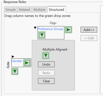

or....to stay in categorical use the structured tab:

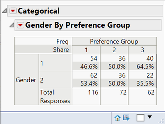

to get....

Thanks, @KarenC. Fit Y by X or the Structured Tab in Consumer Research > Categorical solves my problem.
